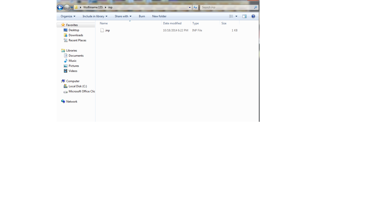

here's a screen shot
- mame problem.png (101.78 KiB) Viewed 10293 times

Re: Recent Verisons of Mame Recording problems
Ok, so the file is created, and is only 1kB in size.
The only reason recording would stop is because you either are out of disk space, or have pressed F3.
Console output would still be useful.
Also, bonus tip: second parameter of record.bat is the INP filename. Use it. Non-Windows treat files starting with a '.' as hidden.

There is a difference, however, in how MAME is recording INPs based on the method he is using. In 153, double-clicking on the "record.bat" file will open the basic MAME GUI and you can select a game and record a full INP that will be named ".inp" in Windows. However, in 154 and 155 it has stopped recording and now just creates a 1 kb INP with a header and nothing else (regardless of disk space or game length). If you open a 153 INP generated this way in a hex editor the header lists the game. In 154 and 155 the header shows "___empty" as the game. I have no clue why this is happening, but this is the real "issue" Brian is having.
'___empty' is likely the shortname for the dummy driver used when no driver has yet been selected. Guess I'll have to add some sort of parameter checking, although that'll probably just annoy him more, because he won't be reading any output from any batch file.

Which would be the menu that MAME gives you when you don't specify what game to play, largely there for dumb people who don't know how to operate a command line application.
I'd guess something has changed in the order in which things happen, the INP file would seem to be created before game selection, or isn't re-created when the system is reset after selecting your game.
