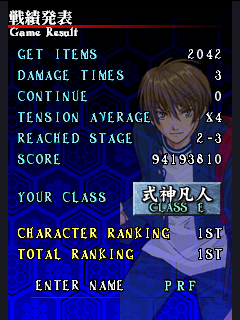

I have been deleting everything manually. I went thru all the folders and deleted everything with the name shikigam except the chd file itself. Also attached is the inp I made just deleting the nvram and I was wondering does it playback at all for you?
prf_shikigam_94104790_wolf150.zip
(213.86 KiB) Downloaded 237 times
Re: Shikigami no Shiro
Plays back, but I don't quite get the same score...
