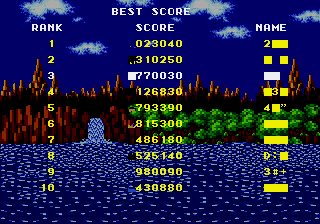

Thought I would look at the Sega Megatech driver seeing as Haze is on vacation, and I thought it would be a good learning experience to look at its BIOS (and the Z80 is the CPU I know fairly well).
Anyway, here's the current status of the driver. http://mahlemiut.marpirc.net/megatechupdate5.zip
And some pics too :)

Disabled the reading on the Genesis ports when a certain bit port is set low. Not sure of the correctness, as it is activated when the BIOS goes into test mode. But maybe that's normal. I don't really know for sure.
Also, changed the DIP switch defaults to 1 coin/1 credit for slots 1, 3, and 4, and 1 coin/2 credits for slot 2, at 3 minutes per credit.
http://mahlemiut.marpirc.net/megatechupdate7.zip
The Genesis input ports are now mapped to the BIOS inputs, so now there is no more doubling up of controls.
Well, it's a start. Still a long, long way to go on this one.

Now I guess I should get all input ports working - just the coin, start, service and test inputs found so far.
